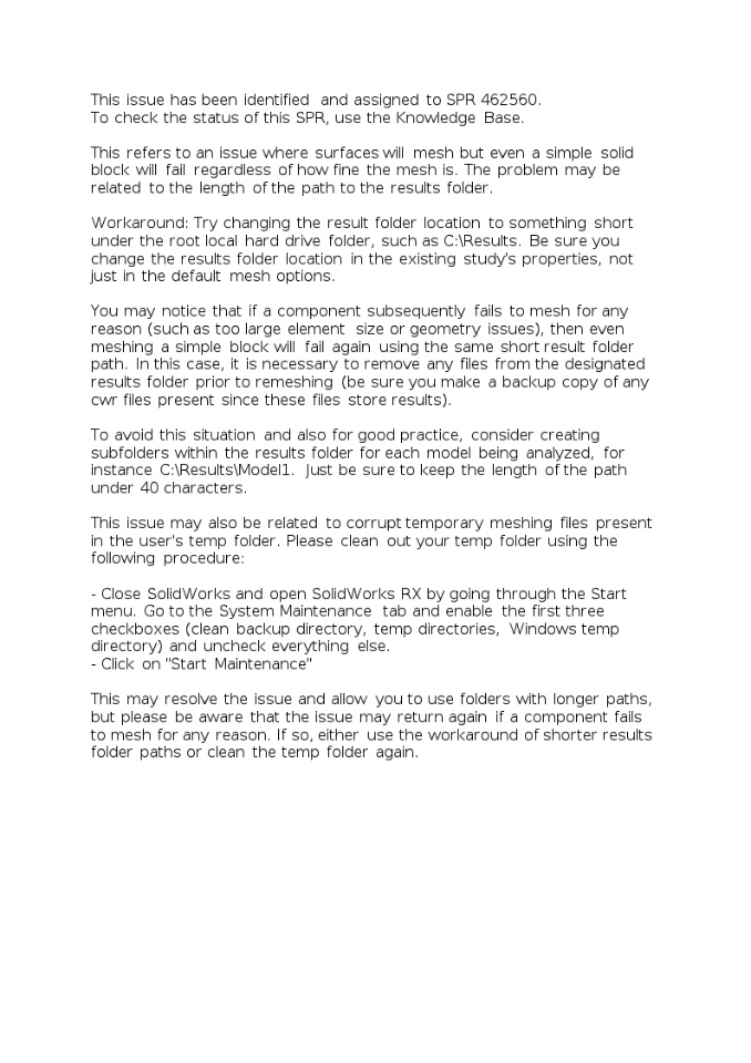

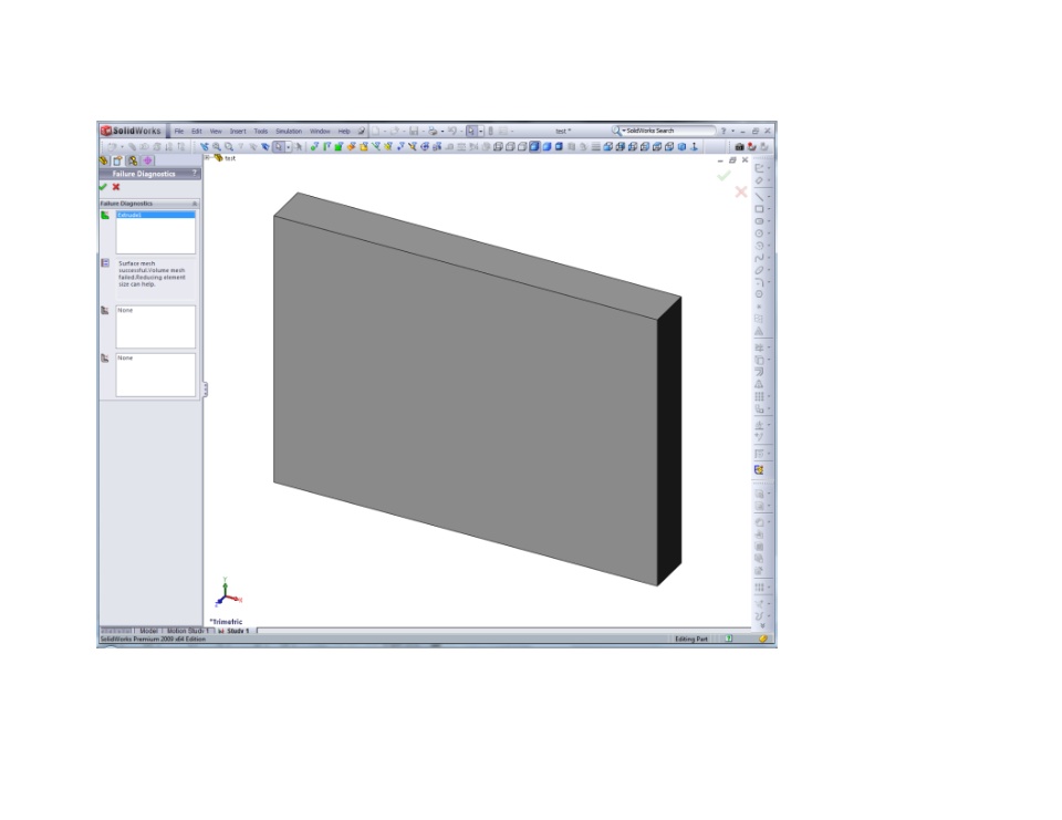

Been using Simulation for some time with good success.  All of a sudden meshing will fail. Even a sample test block without an assembly will fail.
Says "surface meshing OK, volume meshing failed"  Tried all kinds of variations to no success.  Even Simulation Express will not mesh.
What happened/changed.  How do I get back????
