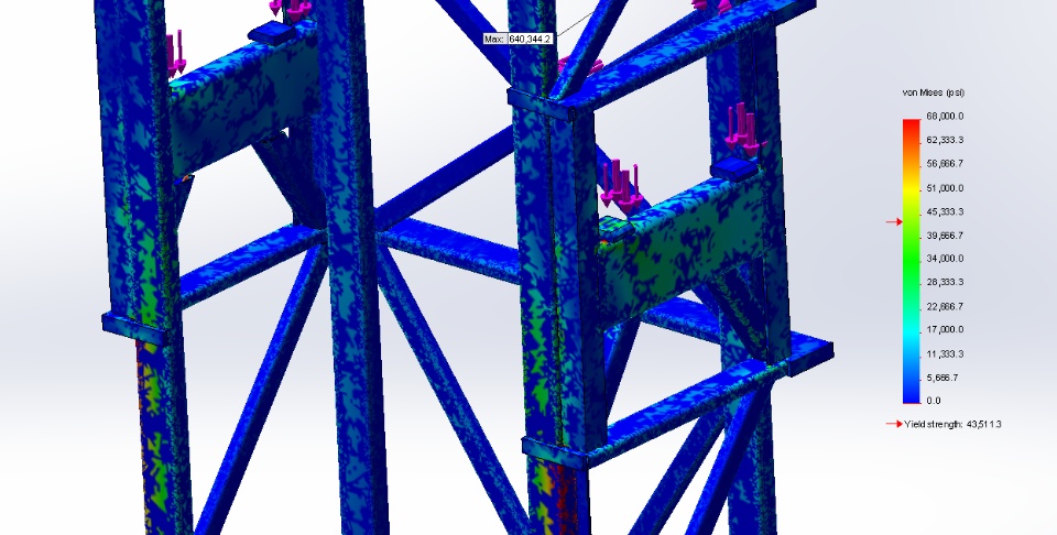

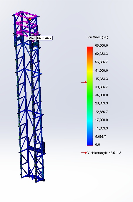

My problem arises when I try to view the results. When trying to open any results files, Solidworks enters a state of fluctuating lock-ups, and the results, if they decide to show up, take a bout 30 minutes to do so. And if they do appear, they are usually garbage. A change in any simulation parameters displays the EXACT SAME results, regardless of the machine the analysis is run on. (I have tried on 2 seperate machines with similar capabilities, transfering the model only, and none of the results files)
Has anyone ever seen this before? Does anyone have any ideas as to why this is happening?
Attached are two images of the stress results. I'm sorry, but I cannot post the model for legal reasons.
