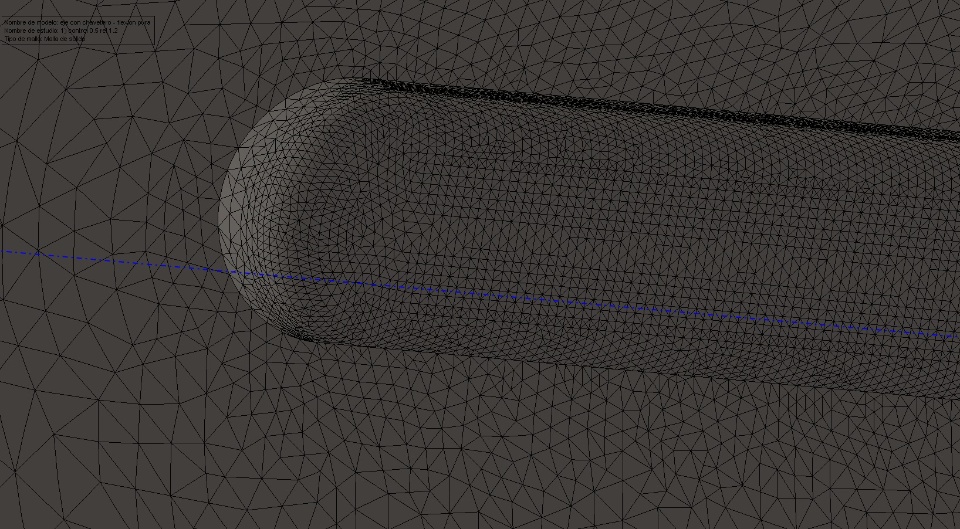

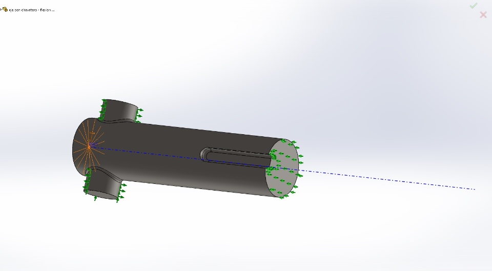

Hi, i have some troble for getting coherent results in a keyseat simulation. I think this is because of the mesh.
let me show you what i mean:
standard mesh with control of 0.5mm, relation 1.2, the mesh is not even(for me)

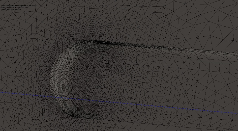

based on curvature mesh:( i think it is a better. the thing is that i only want to focus o the end fillet, not the whole part and i can´t do it with this tipe of mesh)
minimun size of element: 0.5mm
number of circles: 36
relation: 1.2
What else can i do?
