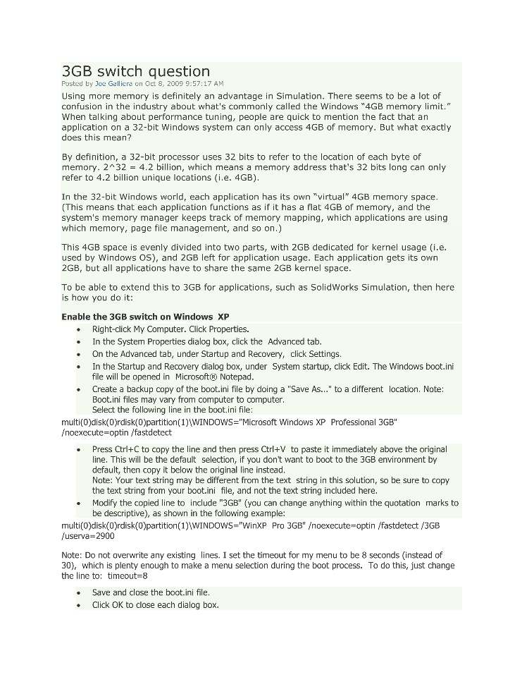

4 GB Ram installed  -  (when i right click on "My Computer" the system only shows 3.25 Gb Ram) ?
