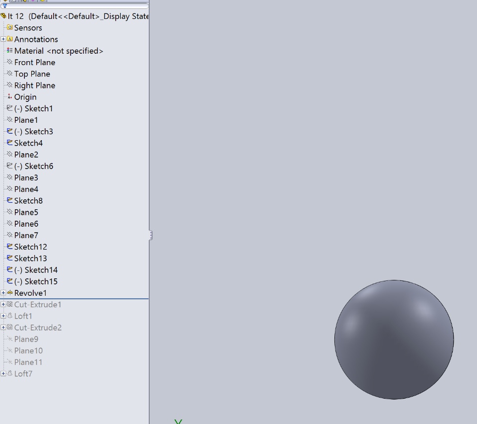

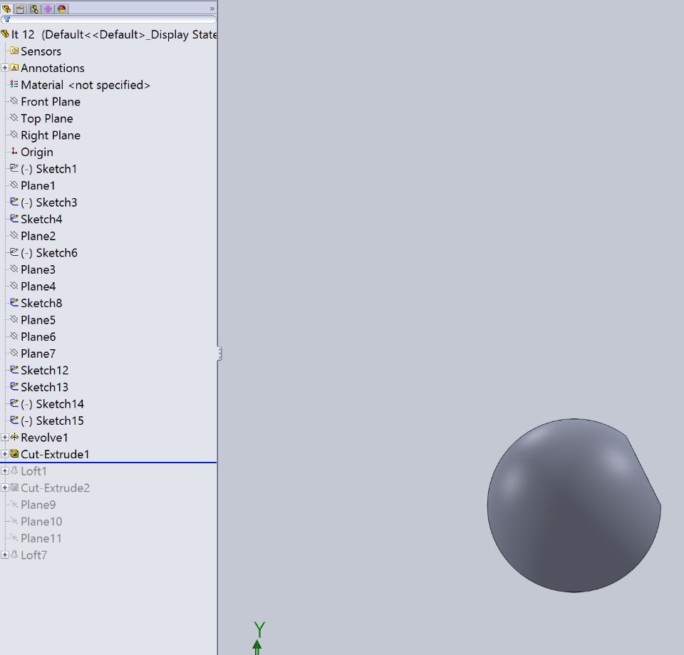

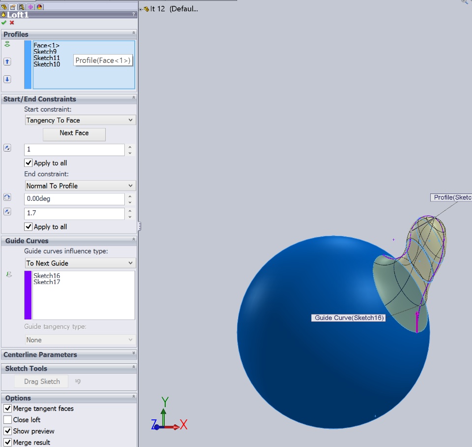

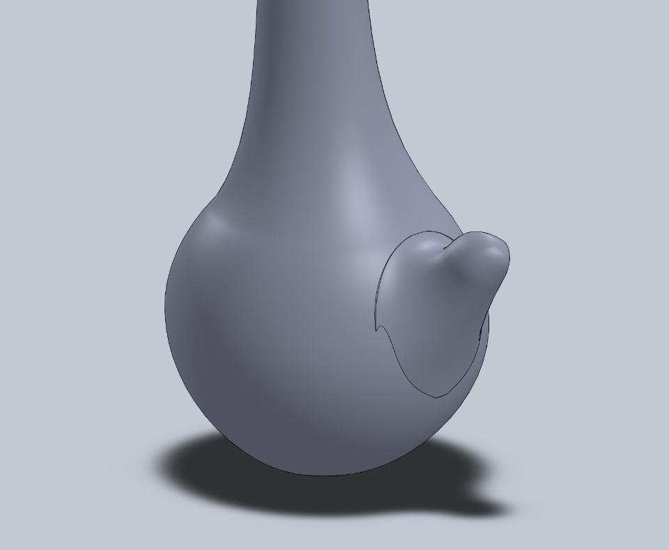

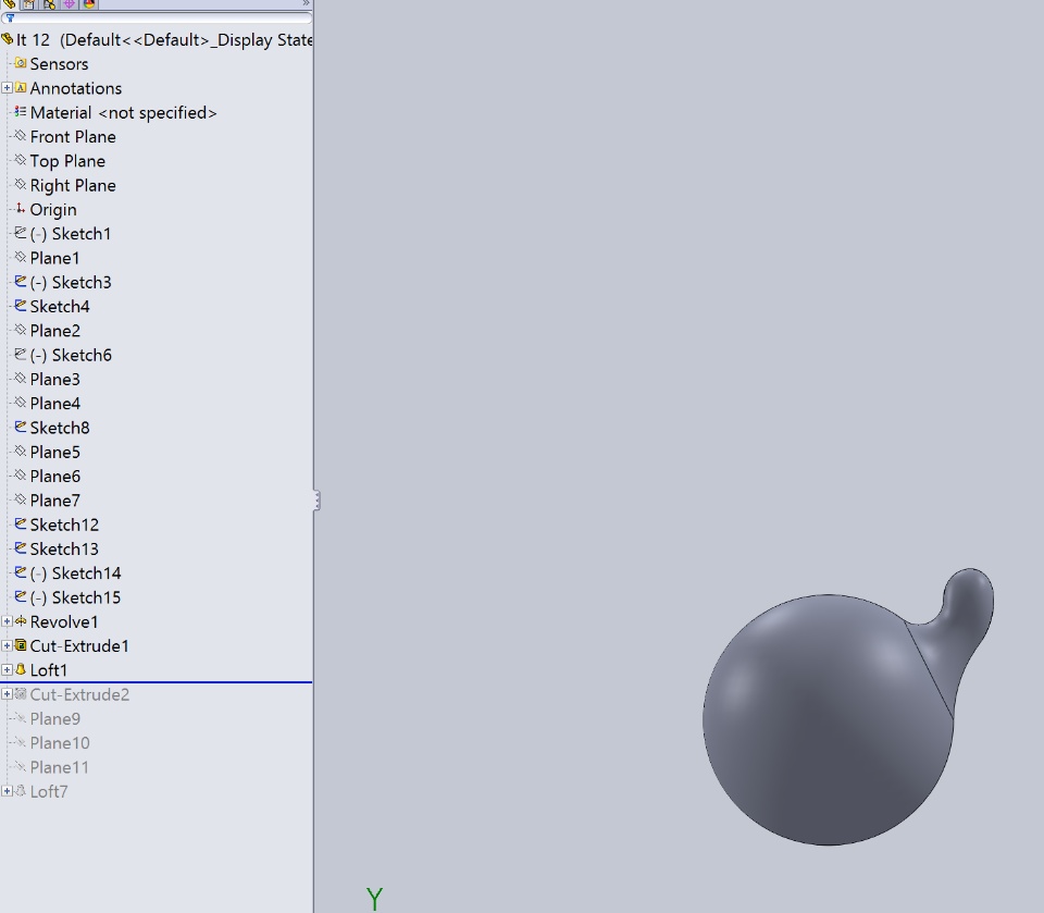

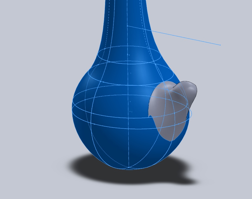

I have two lofts, and I want to join them smoothly - one is essentially a sphere, and the other is a kind of nodule protruding from the side.
Despite having the tangent profiles all piercing the profile of the sphere, it still creates a strange crease at the point of protrusion rather than being a smooth transition. I have tried start/end constraints but it seems to only exaggerate the problem.
Does anybody know how to fix this? I have attached some screen grabs to give you an idea of what the problem looks like.
