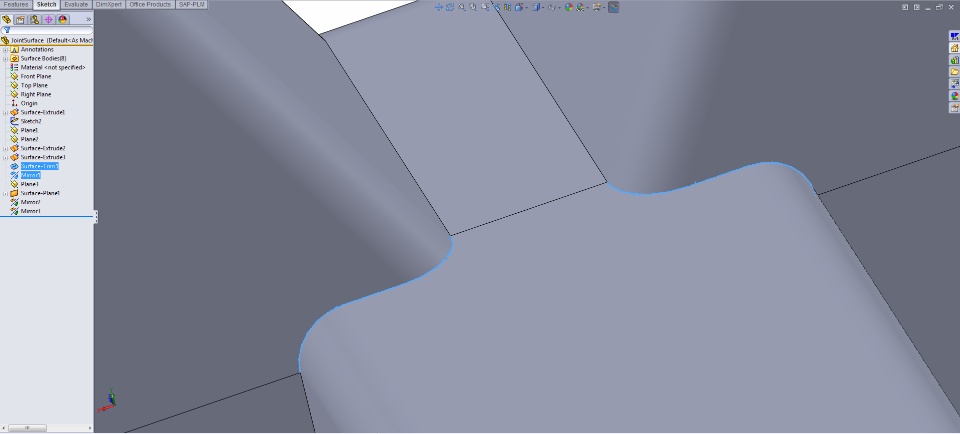

I am working on a simple joint surface. I need to create surfaces and not solid parts because i later send it to Abaqus for analysis and if i can make my part with surfaces it saves me a lot of time and gives a quick analysis.
So, please find attached .sldprt i currently have. it is really simple and done with couple of surfaces.
The thing that is bothering me is that when i transfer this file to abaqus the edges in Solidworks that are shown BLUE are considered free edges. And when i have free edges the calculation is wrong and i have to do more work.
And you can see also on the pictures with even more simple cases that i have edges blue color (free edges)
I have tried with knit function but didn't succeed on making it work.
Is there a way to somehow make this surfaces one part ? or to merge them so they can be one ? Or any way to make this blue edges not free ?
