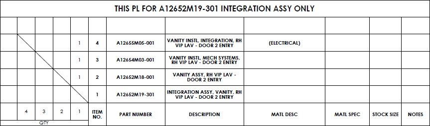

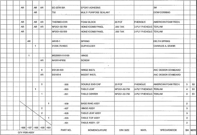

Matrix BOM/Parts List?
Not sure if I'm using the right term here; I guess I'm not really sure what the proper name for it is, but I was wondering if anyone has tried creating one of these type of BOMs in SolidWorks and if/how you were able to still have everything linked. I've been able to replicate the style and save as a BOM template, but nothing is linked. See attached screenshots.
