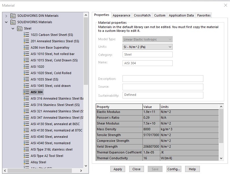

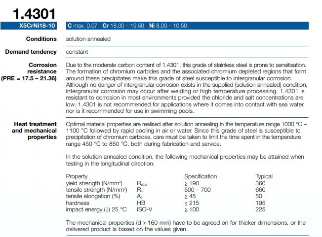

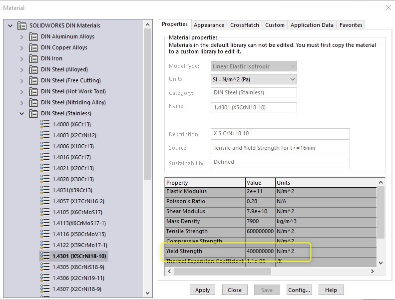

Just wondering how / where did Solidworks found the material properties in material database ?? Made a simulation with stainless steel W.nr. 1.4301 (AISI 304) and wrongly didn't check if the material properties was according to normale manufactores
I bet if you "Google" 20 steel manufacture, you will never find any with more than 21000000 N/mm² (many use 1900000)
Honestly, I'm surprised that someone with mechanical experience will make such a huge mistake and nobody has checked it.
Strangely, if you look at AISI 304 it's more acceptable
