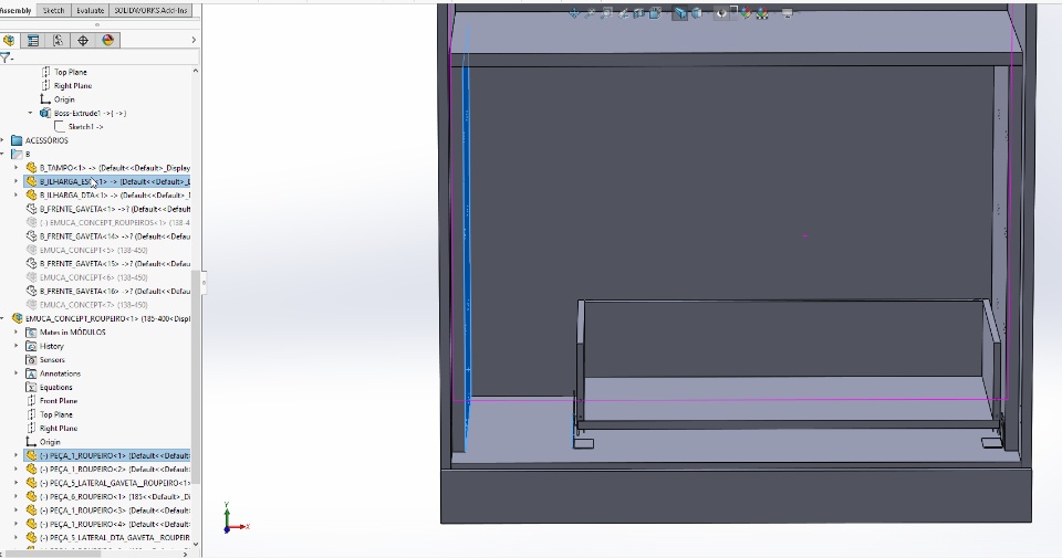

I have 2 different subassemblies, and I want to give two different mates to one of them.
In the main assembly i have this space to put drawers and in the other one I have the drawer. One mate is done, and correct, but I need to put the 2 blue faces coincident. The base and the back of the drawer will automatically follow the sides.
The base and the back of the drawer automatically follow the sides but only when I open the assembly separately.
Is that possible?
