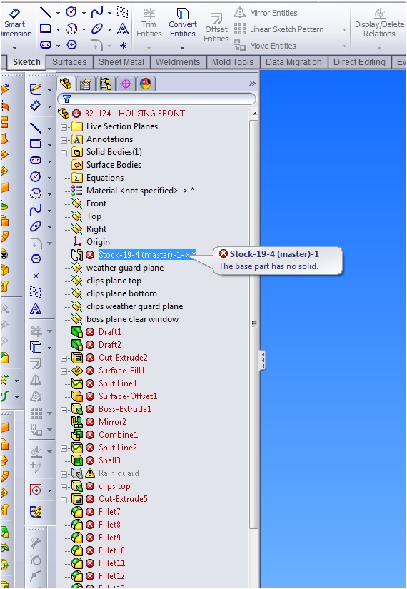

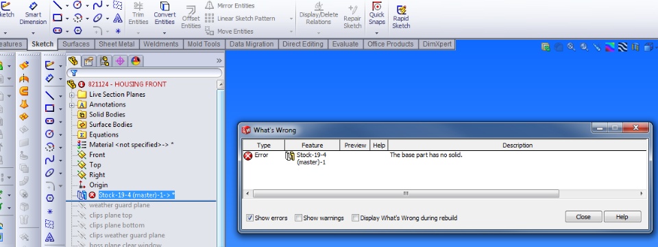

Then, in one of the halve's part file, I created a new configuration. Clicked the default configuration, Control-C, then Control-V. When I hit Control-Q, all the features turn red. The very first feature (where the part was pulled from the master model) gives the error "The Base Part Has No Solid."
I've attached some pix. Does anyone have any idea what that means, what's caused this, or how to fix it?
