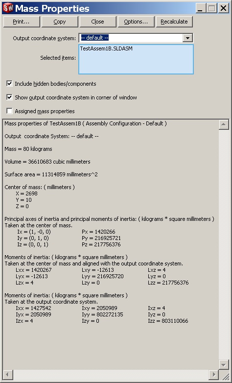

Mass Properties, Moment of Inertia, units of "kilograms*square millimetres" ?
My Document Properties Units are millimetres for length and kilograms for mass.
The Mass Properties dialog reports Moment of Inertia seemingly in units of kilograms*square millimetres.
What I rember from school is that moment of inertia is area in mm^2 x distance in mm x distance in mm.
Kilograms don't come into it, and the units should be mm^4.
How should I interpret the numbers in this report?
