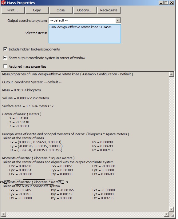

Hello,
I wanted to calculate the mass moment of inertia of an assembly. I used mass properities tool. I found that the unit is incorect for
Moments of inertia: ( kilograms * meters )
Taken at the output coordinate system.
as shown the picture. The units should be kg.m^2. Is that true?
