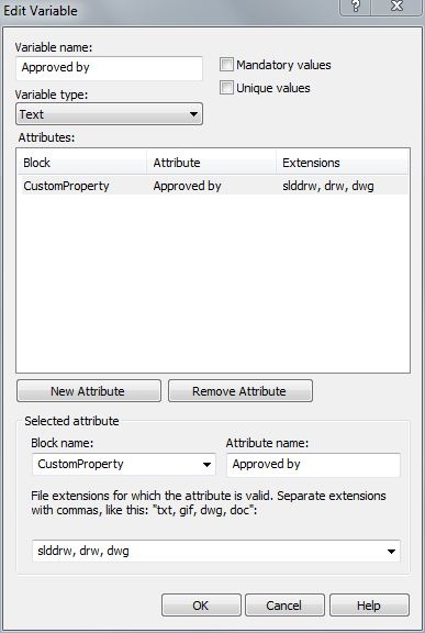

We just started using Enterprse PDM 2010 with our SolidWorks 2010.
I created new drawing sheets.
What we are trying to accomplish is to get the Drawn By, Check By and Approved By names and dates to automatically fill in with the data as the drawings are created and move through the approval process.
I mapped the blocks using the \\\$PRPSHEET:{xxxxx}. Is this the correct way?
Do I need to change the \\\$PRP to something else to get it to pull from the Drawing Data Card?
I cannot get these items to populate unless I put the data under the individual part or assembly.
Is this the way it needs to happen?
