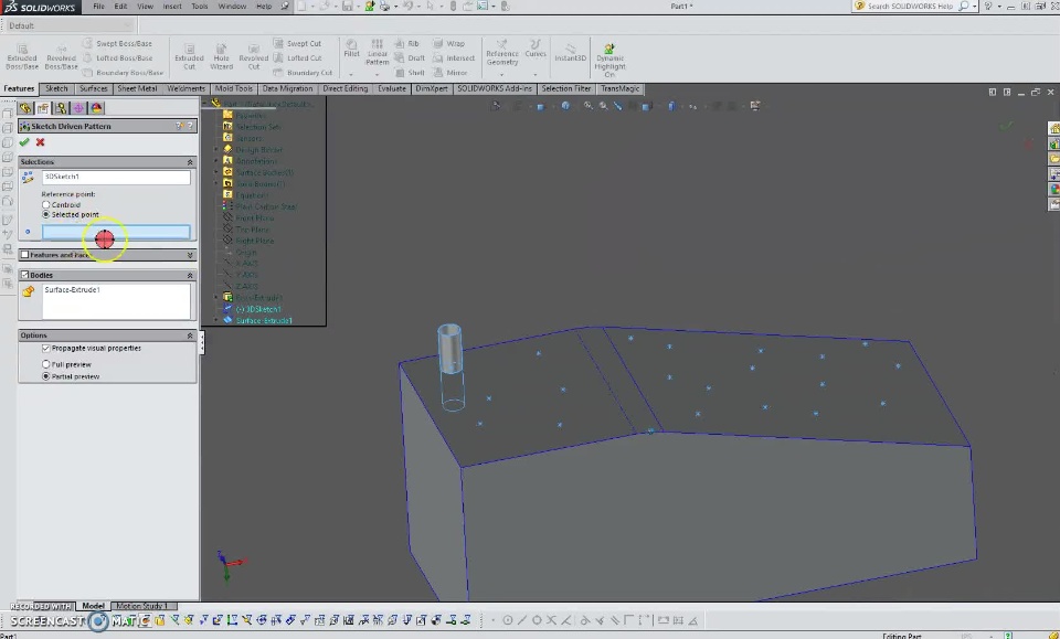

Hi all,
For simulation reasons I need to split surface to many circles with the same diameter(to put force to this circle surfaces). I have sketch with points and I would like to make circles with the same diameter base on this points. Is any way to do it quickly? There is more than 1000 points so its hard to add circle in every point. Maybe do you have any macros? Or maybe there is any method to split surface base on points without doing circles?
Maybe there is any other way to solve my problem - basicaly I need to perform simulation for a part where i need to put force in more than 1000 points. I have sketch with this locations (previously imported from the excel file).
