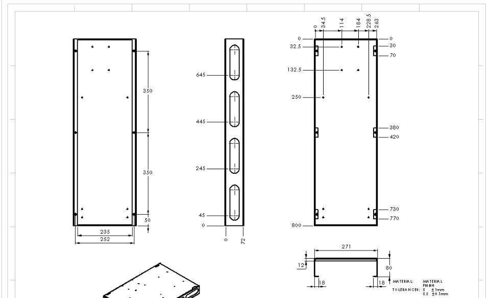

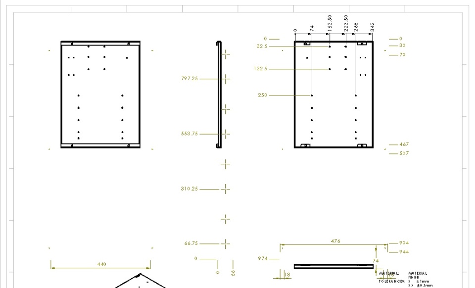

I have a part which has several configurations. I am aware and know how to change which configuration in displayed in the drawing, however most configurations of this part rely on features being unsuppressed/suppressed.
My issue is wanting to only have one drawing file for the part and its configurations. However having the suppressed features alternating from each configuration means when you change the viewed configuration, it leaves dimensions dangling. Is there a way to set up one drawing file of this part with dimensions that only appear for each configuration, or should I just create separate drawing files for each configuration?
I have attached an example by what I mean with dimensions are left dangling.
