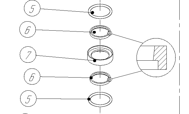

How to make block with different line thickness? We want to use block in the drawing view when we make assembly drawings. To explain witch way a seal (with different diameter) is mounted. See attach picture. It takes long time make new configuration suppress all the parts without the seal. And make cut on it. And drag that view in to the drawing. We think this way is much faster. You have couple of different blocks that you insert, rotate and scale to right size in the assembly drawing. So you don't need to sketch the seal every time. Or someone have another good way how to show how a seal is mounted on the assembly drawing.
