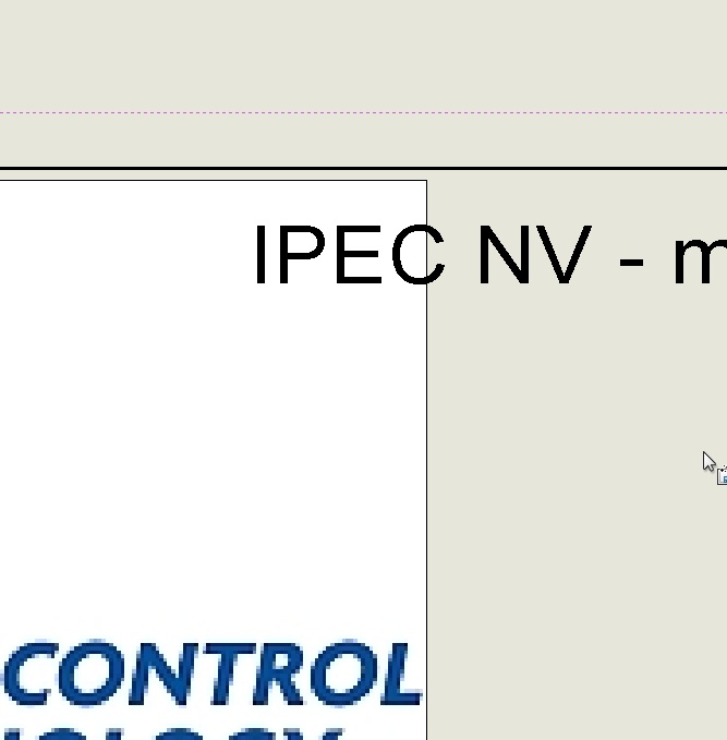

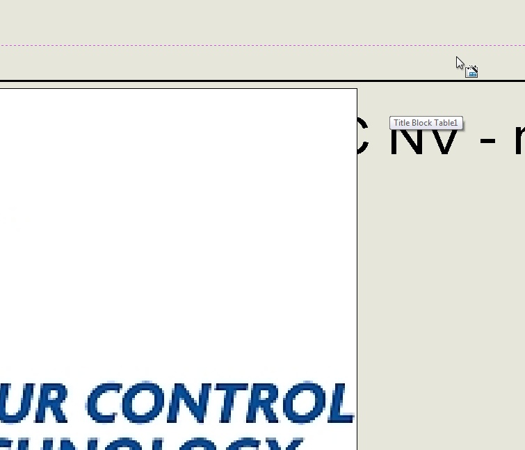

For one of the template that we have to use for a sister company the logo is a picture.  The issue we have with it is that because of the size of the logo and how everything is situated a bit of text keeps ending up behind the logo.
Now we can rectify that by :
- edit sheet
- selecting image
- RMB and selecting the command 'send to back'
The issue I have is that even saving it as the sheet format template doesn't help because as soon as load that sheet format the image will again overlap the text and I can do it all over again.
I have experimented with making the offending area in the image transparent but then the problem arises that the quality of the image gets degraded so much that the logo doesn't only look horrendous on screen but even awful on paper (or in a PDF)
There for my question, does anyone know of a way to have a picture stay in the background or does anyone know of a macro that would do that push to back with less manual steps?
