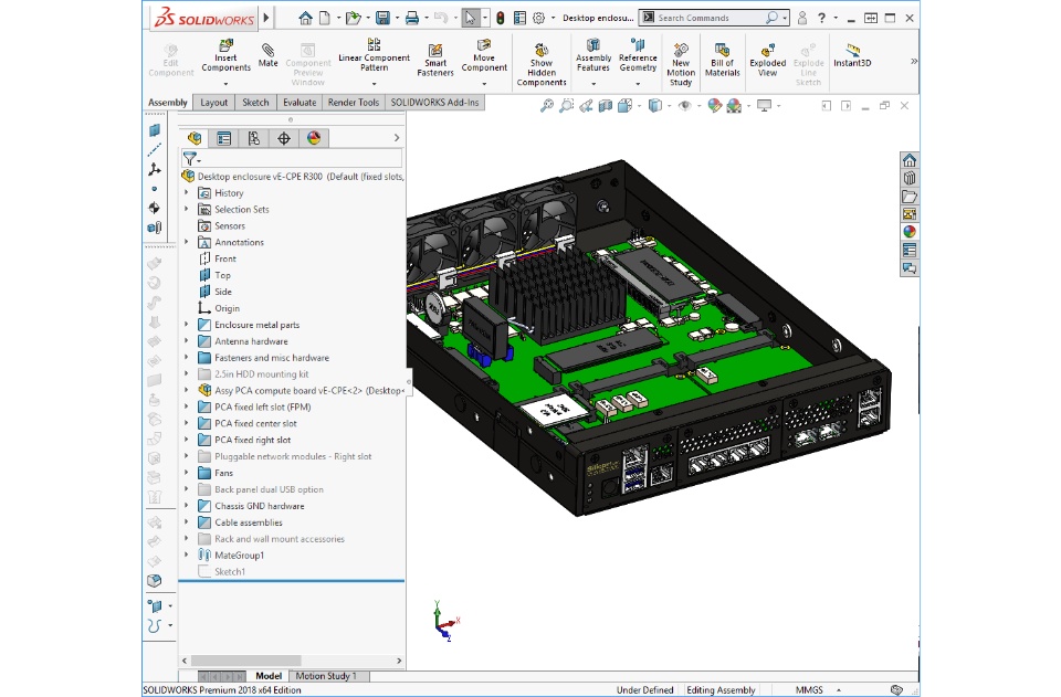

In the FeatureManager design tree, I have created multiple virtual folders and subfolders in order to visually organize and group all of the various parts and assemblies. See screenshot below for reference.

As such, every time I pack-and-go a design, when I open up that new pack-and-go version of the design, all of my virtual folders in FeatureManager design tree are gone; the parts and assemblies listed there have been flattened to a single list view. This is frustrating, as the virtual folders are very useful for organization and efficiency.
Is there a setting somewhere to include FeatureManager design tree virtual folders in a pack-and-go?
