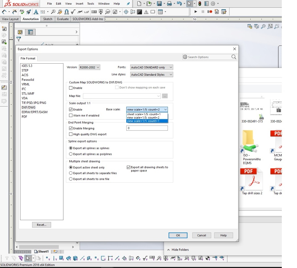

I'd like to know how to include in the macro attached, the option to force the save as DXF (or DWG file) using a scale 1:1. As you can see in the picture you can do that manually in the options from the save as dialog box of SolidWorks, and my dimensions and flat pattern would export great in a 1:1 real size, whereas with the macro it takes into consideration the default scale from the sheet, which usually is 1:5 or something like that.
