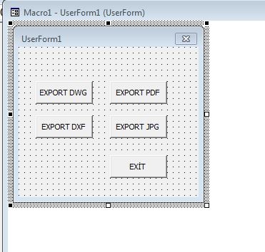

Macro to run another Macro file
hello Deepak gupta
hello Keith rice
I could not
Add example
I have to add a macro
you do
It will be like in the picture
Option Explicit
Dim swApp As SldWorks.SldWorks
Dim boolstatus As Boolean
Sub main()
Dim runMacroError As Long
boolstatus = swApp.RunMacro2("c:\\test\\RunMacroSub.swp", "RunMacroSub1", "main", swRunMacroUnloadAfterRun, runMacroError)
End Sub
Replace "c:\\test\\RunMacroSub.swp"  with the macro path you want to run.
Replace RunMacroSub1 with the other macro Module name.
Replace main with other macro Procedure name
and finally set the options as swRunMacroDefault OR  swRunMacroUnloadAfterRun
