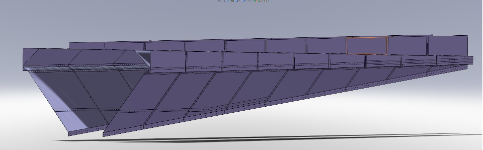

I am trying to create a macro to perform repetitive bends in Solidworks.
Basically I have a large sheet metal part that will be split into your standard 48" x 120" 10 ga. sheets. To accomplish this (as the part contains lofted features) I have cut the part which is 100' long into 10' sections and then created dxf's of my flat pattern and imported the dxf's into new part drawings. At this point I have parts that are 10' long but still 4 sheets wide so i split it up again.
Long story short I have a flat part with bend lines that need the bends added in.
I record a macro which selects sketch 3 (which has one of the bend lines in it), selects the face and inserts the bend angle; problem being that when you select a face the side of the face that you click on relative to the bend is critical. I know a small amount about vb and from what I can tell when I select a face it is taking the coordinates of the location that I have clicked which will not be interchangable from part to part.
Here is a copy of the macro I recorded (there are five bends that are recorded):
