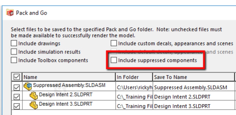

I have written a Macro that automatically creates a pack and go for an open drawing, and I'm wondering if there is a command or method to omit suppressed components, such as the explicit option SolidWorks provides in the options window when manually creating a pack and go:
(I want to do exactly this, just in the macro)
I'm assuming there may be some easy way to do this, such as the command to include toolbox components:
'Include Toolbox Components
swPackAndGo.IncludeToolboxComponents = True
Hope you can help! Thanks,
