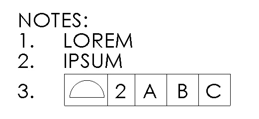

I am currently exploring the use of macro to create the following note
I did run a quick recording of macro and create the note.  The code showed that the note is created by the following code

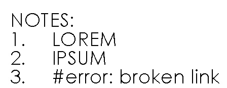

The macro will only work on the drawing that i create the inline GD&T note manually.
When used on other drawing, the GD&T will appear as broken link (which is sort of logic since the macro did not create the invisible GD&T feature)...
Appreciate if anyone can point me to the correct way/direction of creating the note with inline GD&T feature using macro.
