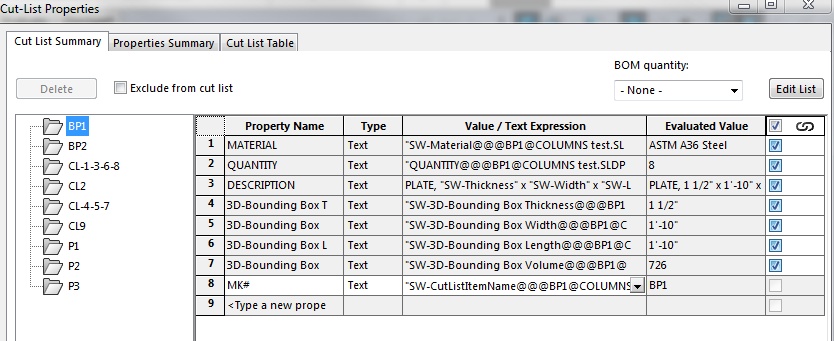

Hello,
I have a macro that I found here that I am trying to modify to create a Property with the Cutlist Folder Name as its value like the MK# shown here that I manually inserted:
I've modified the macro and it runs but unfortunately doesn't actually do anything.  Any help would be appreciated and if you could point me to some resources to learn Solidworks specific VBA I would love that as well.  Thank you in advance!
Here is the macro:
