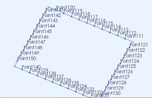

I was wondering if there is a way to create a macro similar to the reference points tool that could;
1.)Step1:generate n number of points along a line. (Reference points is limited to 100 points but its exactly what I would like to replicate)
     It could take any sketch and turn any lines within the sketch into the points
From this
To this
