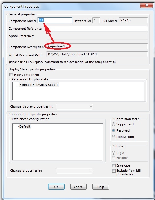

Hi everyone,
I need a macro to change component name with component description..
I found this code but for the moment i don't know how to modify it
