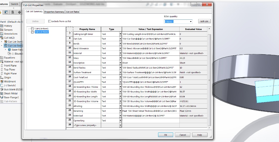

On my Solidworks 2017 sp4 version i'm running a macro to automattically create/fill a cutlist with my own property names for sheet metal body's.

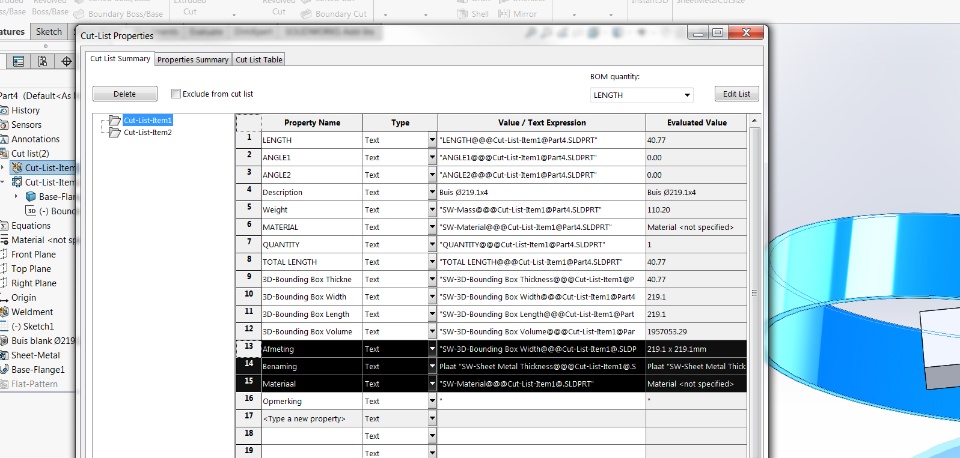

Now i've got a problem with this macro.
When i'm running this macro for a PART with multiple body's (sheet metal, weldments and extrudes) it's it's also changing the custom property's for my weldment files.
Is there anyone right here who can add an exeption to this macro? something like only change 'sheet metal' cutlist items?

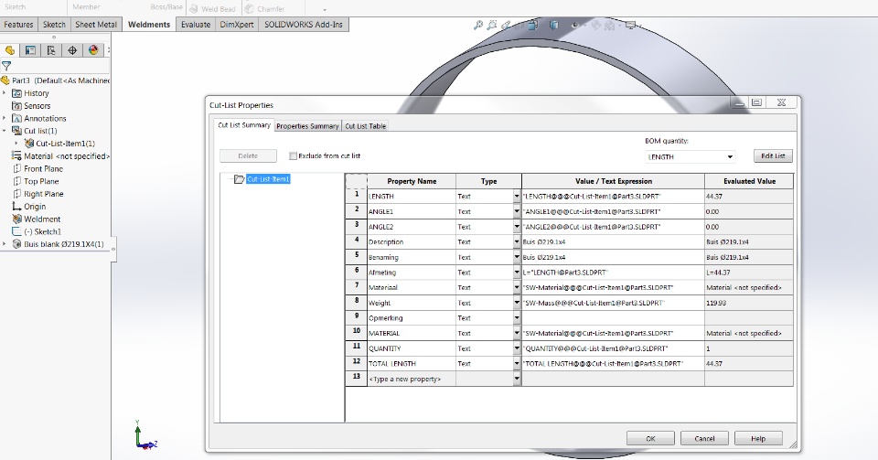

Only a weldment works fine (no macro needed for the right custom propertys)
after adding a sheet metal body and running the macro, the custom propertys of the sheet metal are fine
but it also changed the weldment's custom properties by adding a bounding box.
