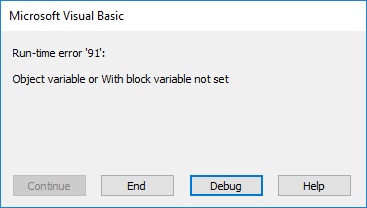

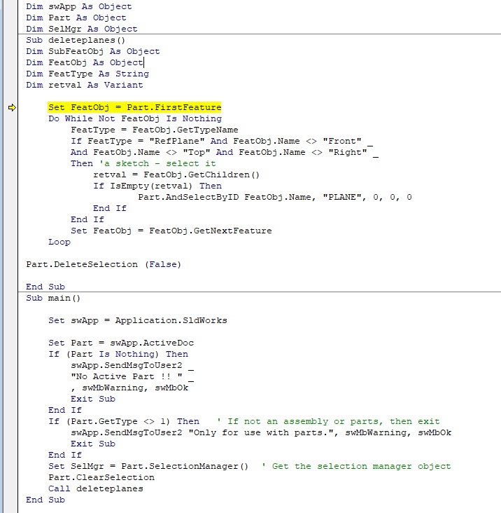

I have a macro that is suppose to delete all unused planes. I did not write this, was download from a free site. It is giving the run-time error 91. I do not know enough about macros to correct the problem. It seems to be telling me the Set FeatObj is the culprit. Any suggestions?
Thanks.
