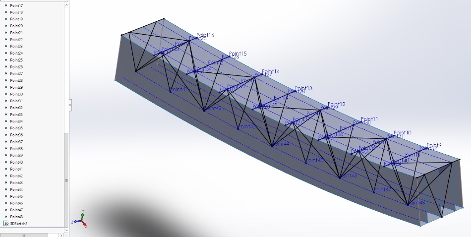

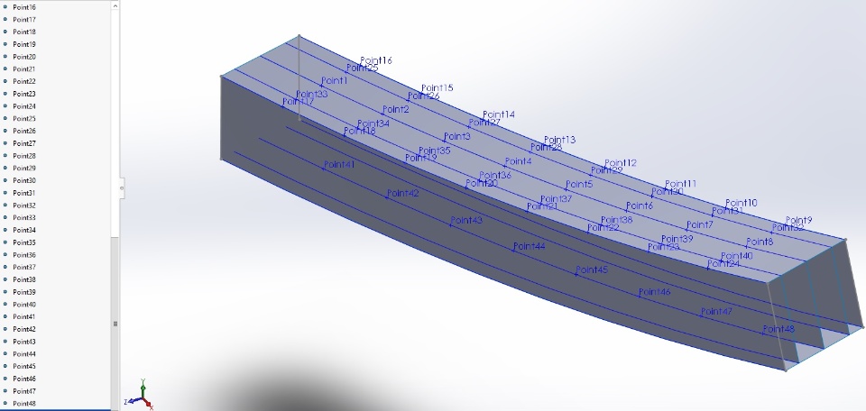

I have over 150 parts that need to have lines sketched between points. The points are created as reference points in the same order, so the point numbers will be the same, just in a different XYZ location. I use the top centerline to create 8 evenly distributed points on the center line and then simply project the center line points onto each respective surface (seen in Figure 1)
From here I go into 3d sketch and start connecting the points. First I connect the profile (seen in Figure 2)

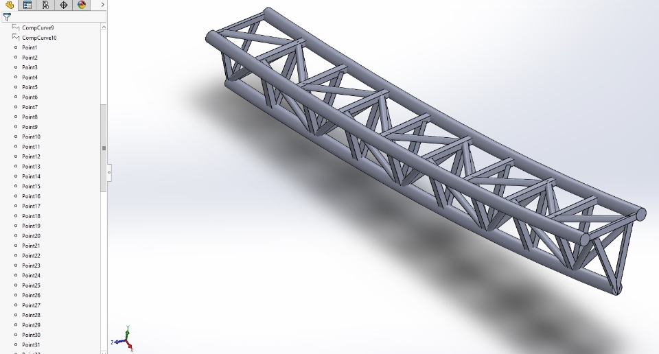

Once the profile is complete I then connect the cross bracing members. (Seen in Figure 3)

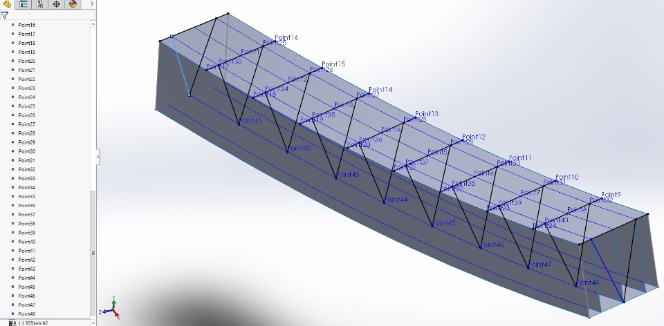

Figure 3 is the desired result I am looking for from the Macro. Once I have the lines I can simply create weldments for the final product as seen in Figure 4. Please note that I have not trimmed any of the members and this is just to give you an idea of what I am trying to create.
