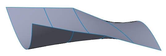

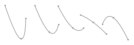

Facing an interesting challenge; I have a series of 3D spline curves that I need to turn into a series of lofts. Each loft is between two adjacent curves in the series. I have code that generates over a thousand curves which I can load using the ScanTo3D utility. I can then manually create each loft, but given the snail-like performance when the massive amount of data is present, it takes an unreasonable amount of to do it by hand.
So, I figure its high time to jump into the world of writing macros! I have yet to find one that does this task.
From mucking about, I have code that kind of works, in that it selects the curves in the correct order. However, I have so far been unsucessful in creating a loft feature. Has anyone created surface lofts or similar features before? I am sure its something obvious that I am missing, but I am not familiar with either VBA or the Solidworks API...
Attached is part with a few curves as a generic representation of the problem, as well as the code I have so far. The code has two sections, one that uses InsertLoftRefSurface2 and one that uses CreateLoftSurface. Neither one works. Currently just attempting one loft operation, will expand it to the full series once that is working. Any ideas or pointers?

If your splines are in one 3DSketch, then they should be treated as SketchContours. Try following code, which I tested on one 3DSketch:
<p>Dim swApp As SldWorks.SldWorks</p><p>Dim swModel As SldWorks.ModelDoc2</p><p>Dim swSelMgr As SldWorks.SelectionMgr</p><p>Dim bRet As Boolean</p><p></p><p></p><p>Sub main()</p><p>    Set swApp = Application.SldWorks</p><p>    Set swModel = swApp.ActiveDoc</p><p>    Set swSelMgr = swModel.SelectionManager</p><p></p><p>    Dim swFeat As SldWorks.Feature</p><p>    Dim swSketch As SldWorks.Sketch</p><p>    Dim swCont As SketchContour</p><p></p><p>    Dim vCont As Variant</p><p>    Dim vConts As Variant</p><p></p><p>    'Get selected sketch and its contours:</p><p>    Set swFeat = swSelMgr.GetSelectedObject6(1, -1)</p><p>    Set swSketch = swFeat.GetSpecificFeature2()</p><p>    vConts = swSketch.GetSketchContours()</p><p>    Dim swConts() As SldWorks.SketchContour</p><p>    ReDim swConts(swSketch.GetSketchContourCount - 1)</p><p>    Dim i As Integer</p><p>    For Each vCont In vConts</p><p>        Set swCont = vCont</p><p>        Set swConts(i) = swCont</p><p>        i = i + 1</p><p>    Next</p><p></p><p>    'Select two contours with mark 1</p><p>    bRet = swConts(0).Select(False, 1)</p><p>    bRet = swConts(1).Select(True, 1)</p><p></p><p>    'Create Loft:</p><p>    swModel.InsertLoftRefSurface2 False, False, False, 1#, 0, 0</p><p></p><p>End Sub</p><p></p>

CreateLoftSurface gives you more flexibility meaning access to all Loft Feature options. This function needs an array of Curves. To get curves you must get SketchSegments instead of SketchContours and for each segment call GetCurve().

Excellent! That works great! Added loop to run through the array.
<p>  ' Iterate through array of contours</p><p>    For i = 0 To UBound(vConts) - 1</p><p>        'Select two contours with mark 1</p><p>        bRet = swConts(i).Select(False, 1)</p><p>        bRet = swConts(i + 1).Select(True, 1)</p><p>        'Create loft:</p><p>        swModel.InsertLoftRefSurface2 False, False, False, 1#, 0, 0</p><p>    Next i</p>
Many thanks for your speedy reply, Krzysztof. I can't tell you how much monotonous clicking you've saved me, it is much appreciated.
