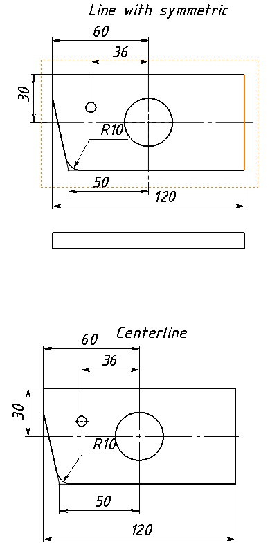

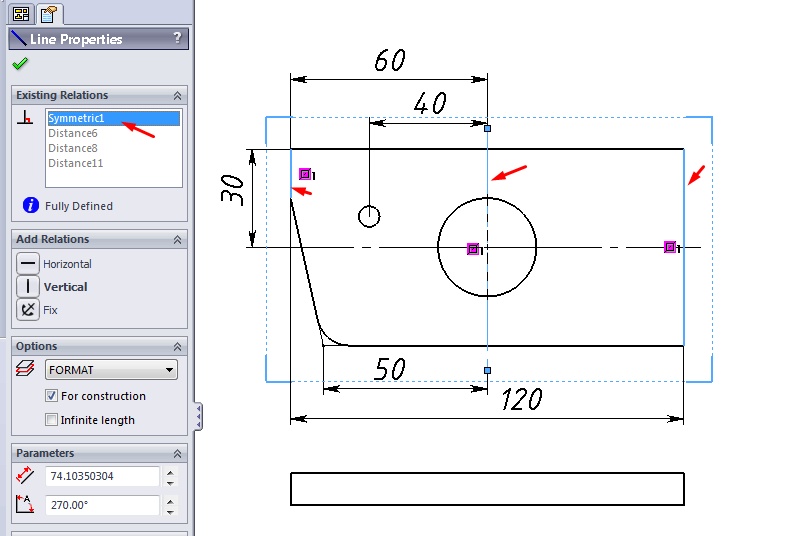

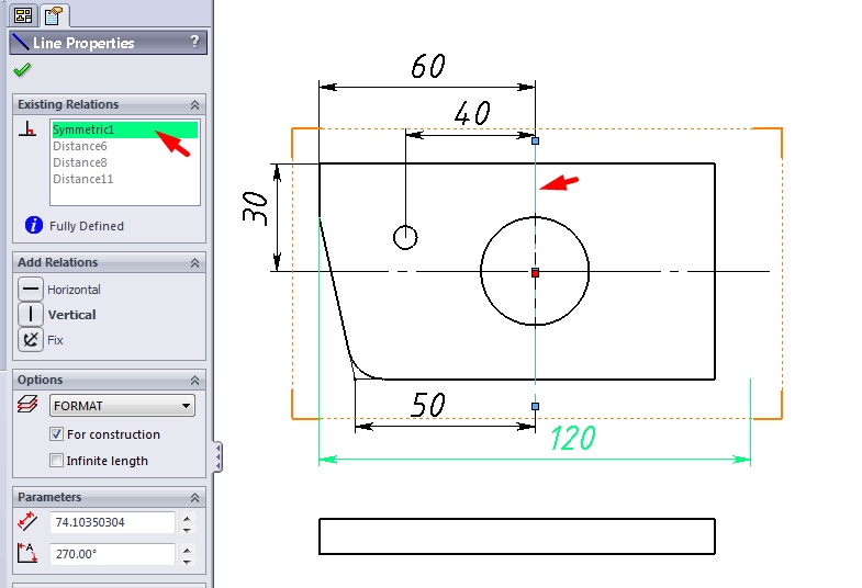

On example pictures I have a plate with axis of symmetry with relation "symmetric" (Screenshot_1) and point with "intersection" (2). After losing right face of part dimension "120" bacame dangling and change its color (on green in my settings - Screen_3). And axis of symmetry stay black but have dangling relation (Screen_4) and now its not axis of symmetry of the part. And all dimensions from this axis is wrong.

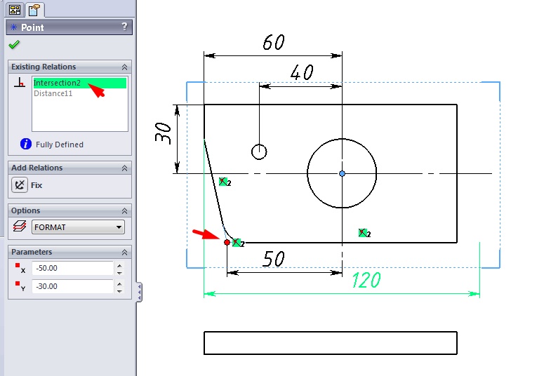

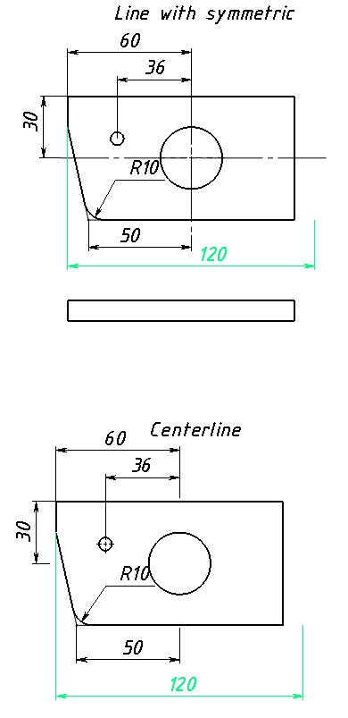

The same with point (5).
