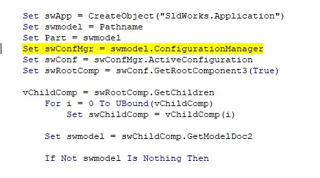

Macro error HELP !

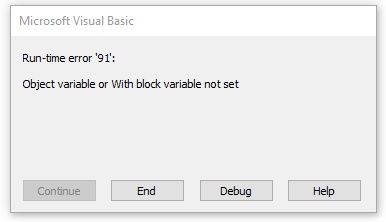

The following macro to make flat pattern form assembly file was working fine and well for me. But after i updated my standard SW license to Professional suddenly it stooped working and gives me an error,
Can anyone please help me on this.

Set swApp = CreateObject("SldWorks.Application")
Set swmodel = Pathname
Set Part = swmodel
Set swConfMgr = swmodel.ConfigurationManager
Set swConf = swConfMgr.ActiveConfiguration
Set swRootComp = swConf.GetRootComponent3(True)
vChildComp = swRootComp.GetChildren
