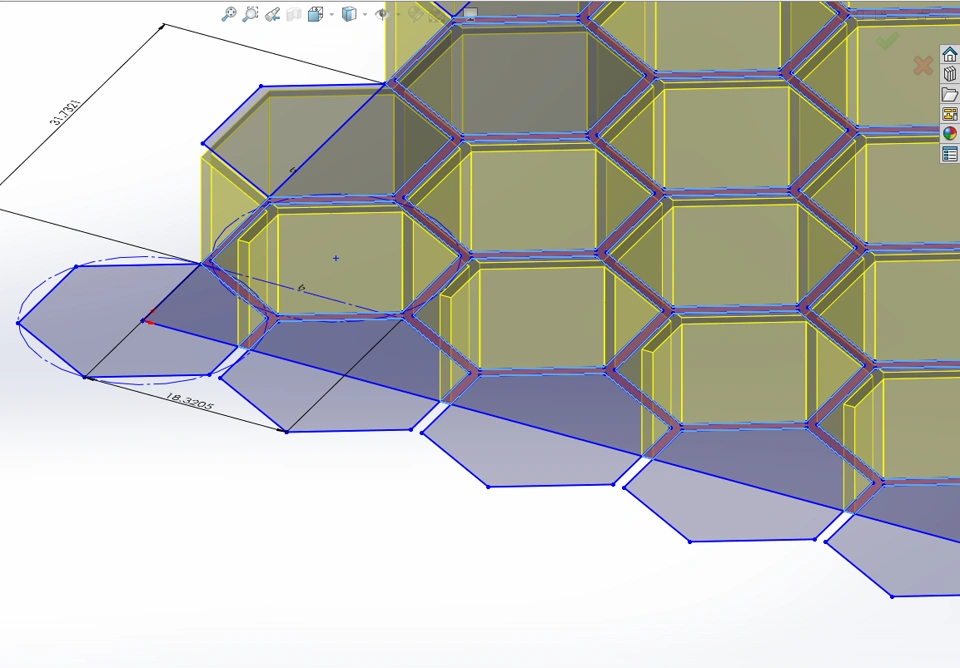

I constructed a hexagonal lattice using a macro (and C++ code), as shown in this screenshot:

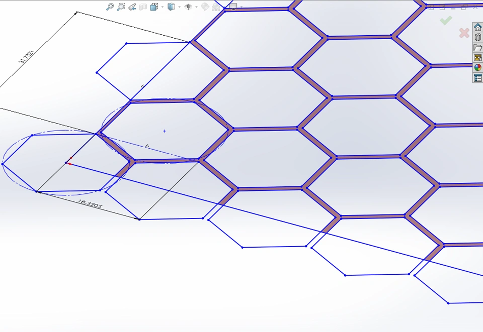

I want to extrude the highlighted part, which is easy to do in the user interface by just placing the mouse cursor over it. When I do that it gets highlighted as in the figure above. When I click on it I get the preview as in this screenshot:
I want to automate this in a macro and eventually C++ code. So far, I can generate the hexagonal lattice. The issue comes when I want to select the in-between region. By recording the macro when I do it in the user interface, something like the following is executed:

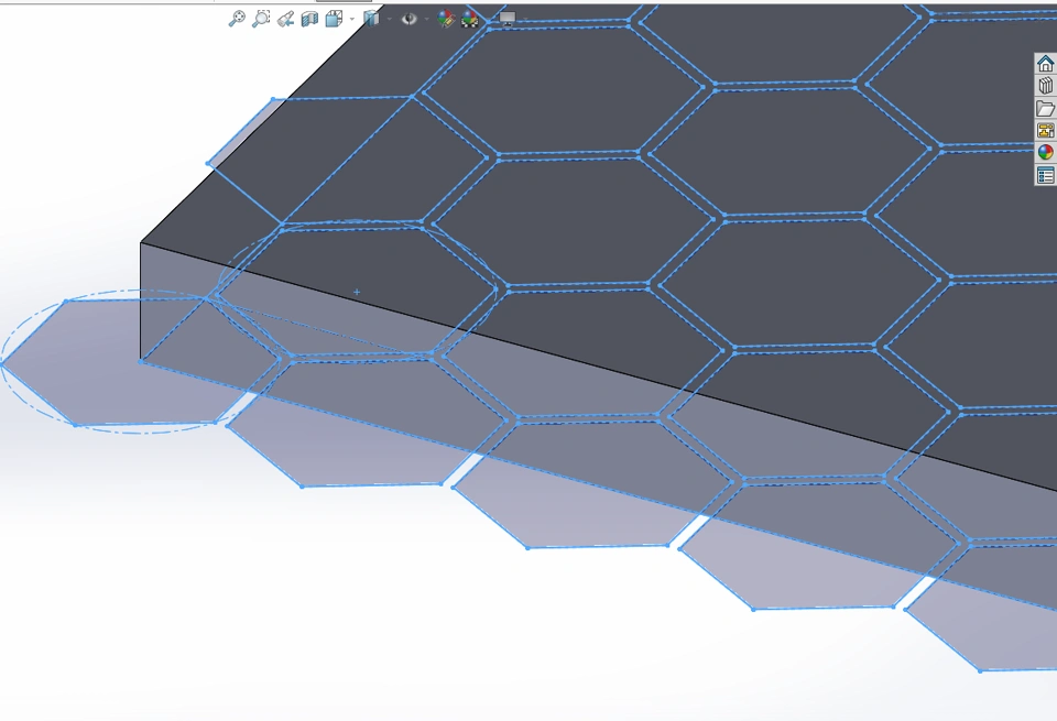

I have figured out that in SelectByID2 I need to use a point in the in-between region. In the code above (-4.67252537465528E-02, 6.2363156480319E-04, -2.53256663975568E-02) is one such point. However, when running the macro, the in-between region is not selected but it selects the rectangle and extrudes it as shown in this screenshot:
So, how can I select the in-between region to extrude only that as in the second screenshot?
