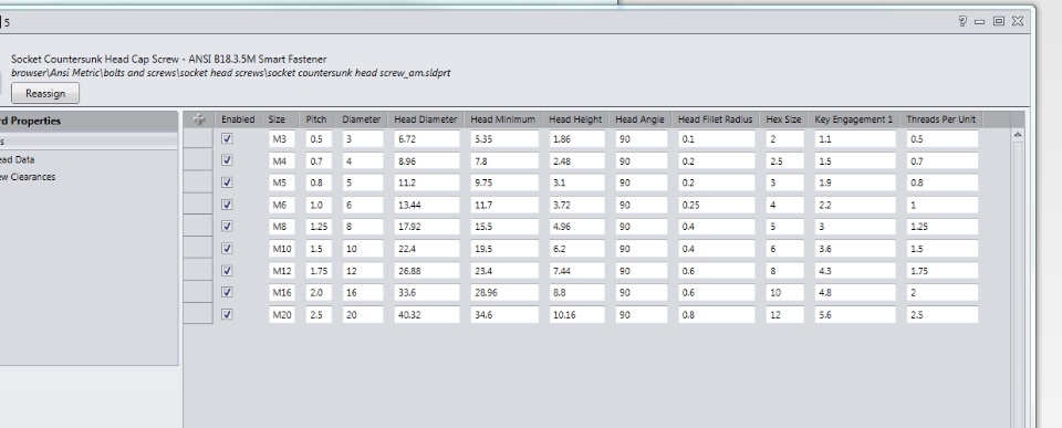

I need to add an M30 countersunk bolt to the toolbox bolts.
After spending an hour plus trying to find this size properties (head size / depth etc) the nearest I have found is for M24.
Can someone point me to a site where I can find properties / sizes for larger bolts.
I also need this to be metric sizes.
Edit
Attached are the parameters I need to fill in to add a M30 hole size (or so I believe).
Does anyone have a PDF explaining how to add hols and bolts to the toolbox.
