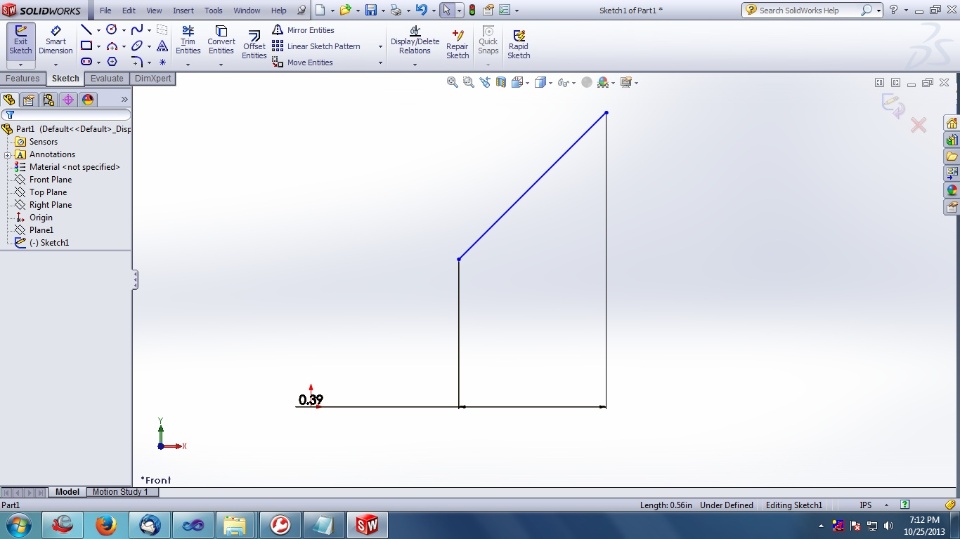

    As expected, the dimension label is seen at origin: Please see snapshot DimLabelAtOrigin.jpg
    My question:
    Is there any API which automatically aligns the dimension label in a sketch at appropriate location? This API should compute appropriate dimension label location internally.       By using this API, we can align the labels appropriately even if they are located at origin initially using IAddHorizontalDimension2 or IAddDimension2 etc.
