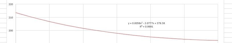

am not having much luck defining a helical curve using an equation. the cam profile follows this equation
but i cannot figure out how to generate the helix in SW. have tried variable pitch helix and equation driven curve but no luck.
Anyone have an example part to share so i can see how its done?
here is a table of the height vs angle.
