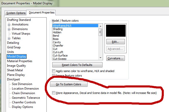

I've created an assembly of 10 parts. On one of them I've puted a logo (which was "imported" from another file, nothing special just not one of those that are already in the library of logos). Then it shows also on the part in the assembly. Like it should be and it's great.
But when I zip all the parts, the assembly file and the image of the logo into one and then extract it in another place/file (just to check if everything was copied etc because I need to send all it to someone) I saw that the logo isn't showing up on the part and also not on the assembly and I've no idea why?
