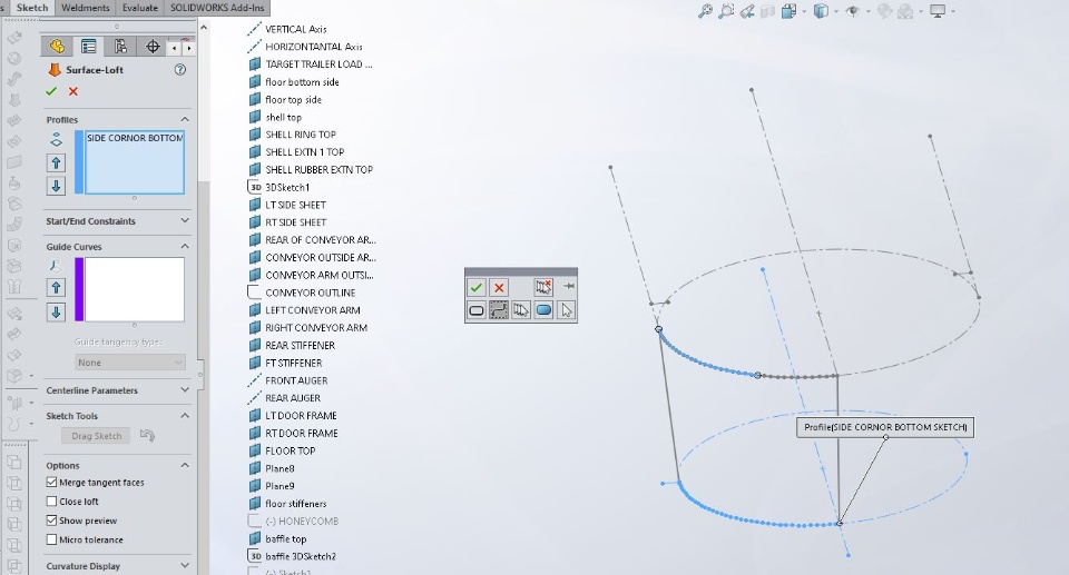

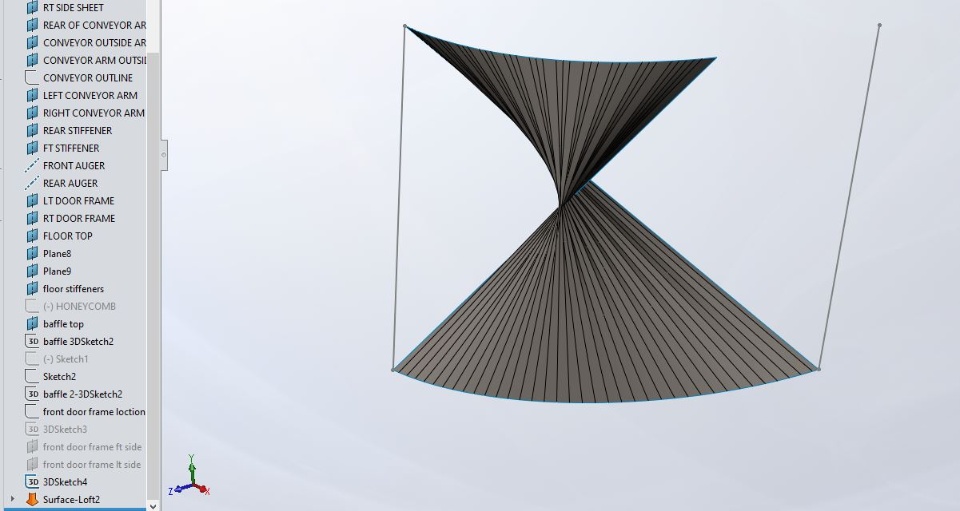

In designing a new mixer shell We are attempting to use a Skeleton sketch while in the idea phase. As our sheet metal abilities do not include being able to roll a large sheet with different radisus on each end yet we bump break the sheet with a different spread between the breaks top and bottom. To make the end model and drawing easier I am currently attempting to place a sketch in the SSP and create the lofted surface to verify it works. and currently it doesn't. I have counted the number of segments a couple of times to verify (I think) that they are the same number. When I select the sketches to create the loft it will only select part of the top sketch, and then twists the surface. Can someone please suggest where my error is? Is this even the correct method? is there a better one? Thank you
