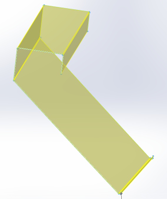

I have a simple sheet metal part that has 2 sketches on parralell planes as reccomended in the help documentation.
Equal number of staight sketch segments and equal number of rounds in corners to ensure a 'smooth' profile.
The sheet metal thickness of 0.5mm, and the radii in each sketch is 3mm.
SEE BELOW FOR IMAGE:
When creating the lofted bend feature we a have an option to alter the number of bend lines. This defaults to 2 in our case
**We need to have only 1 bend line which is in the centre of the sketch round as we will be cnc machining this from the flat pattern sketch.
Can anyone provide advice on how get the number bend lines down to1, or what effects this parameter? I've done alot of research on forums / web etc but havn't seen this one come up as yet.
