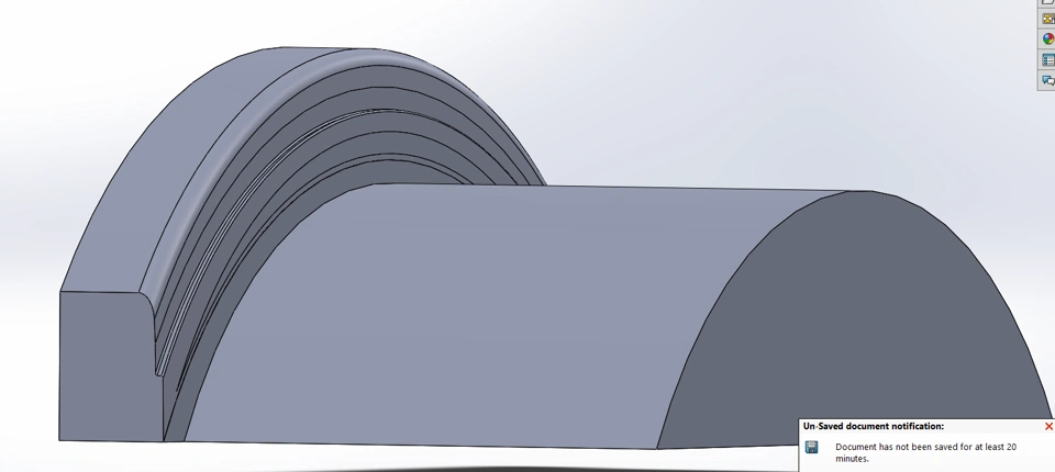

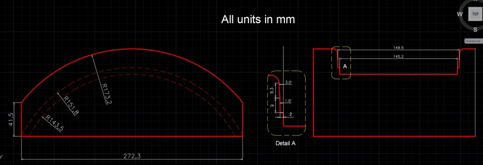

Hi everyone. I'm new here and need some help. I've facing some problem with loft command with my 2D drawing using AutoCAD and I want to make it 3D using SolidWorks 2018. First of all, I try to make guide curve with profile ( 3 Radius ; 173,2 ; 151,8 ; 143,5). But, the result is not what I expect.
