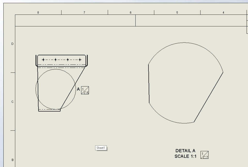

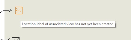

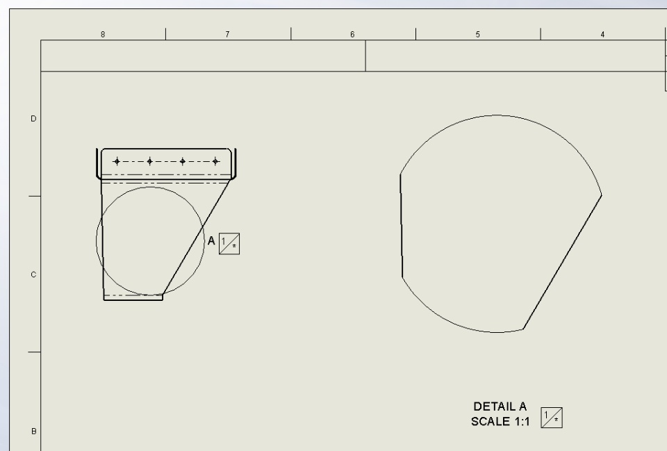

I am attempting to update my template to utilize the new feature of "Display zone of counterpart location label" for my drawing location labels. When i utilize this option however the zone becomes an asterisk, acting as though it is not linked. This does not happen though when displaying the centroid of the view.
This first image is with the box checked "Display zone of counterpart location label" (which is what i want)
The following is the same exact views and document with the box unchecked pointing to the centroids:
