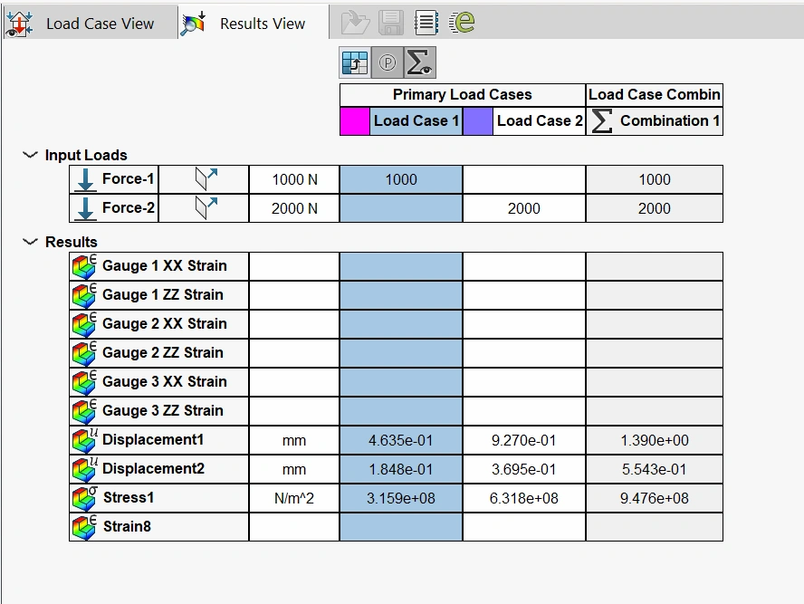

I am trying to use the Load Case Manager to apply varying forces to my model and monitor the displacement and orthogonal surface strain at various reference points, representing crossed strain gauges. Deformation and stress gives results, but every strain measurement is blank.

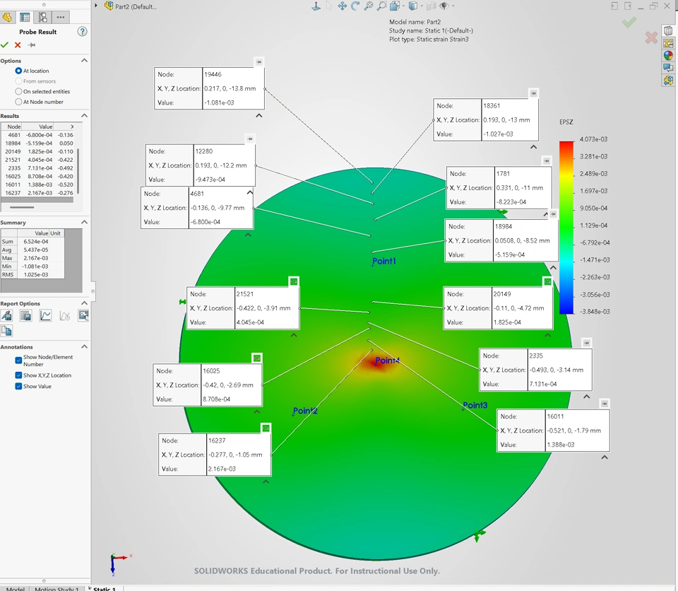

There are definitely values available as this screenshot shows:
How can I resolve this?
