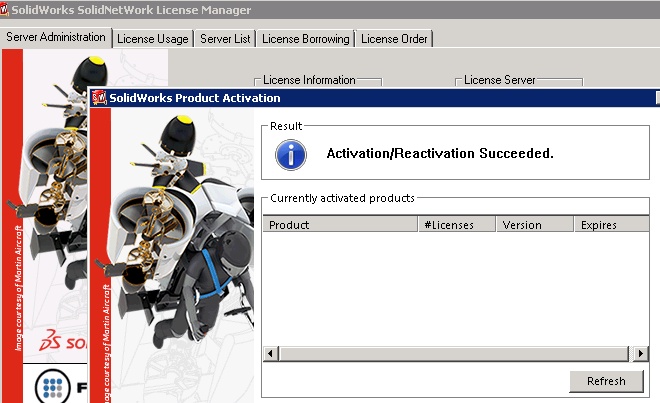

(lmgrd) SW_D exited with status 255
Hello,
I have installed SNL 2014 SP5 on my Windows 2008R2 server. Windows Firewall is off and lmgrd.exe and SW_D.exe are in my SEP exceptions list. I can successfully telnet to the server on 25734 from a client machine.
After installation, I went through the activation wizard (internet) with my valid license key, and got an 'Activation Successful' screen. However, no products show up in the list and when I click the License Usage tab I get a message: Could not get information from this server.
Below is my log:
11:10:45 (SW_D) FLEXnet Licensing version v11.9.0.0 build 87342 i86_n3
11:10:50 (lmgrd) SW_D exited with status 255 ()
11:10:50 (lmgrd) Since this is an unknown status, license server
11:10:50 (lmgrd) manager (lmgrd) will attempt to re-start the vendor daemon.
11:10:50 (lmgrd) REStarted SW_D (pid 7668)
Appreciate any help with getting this online.
