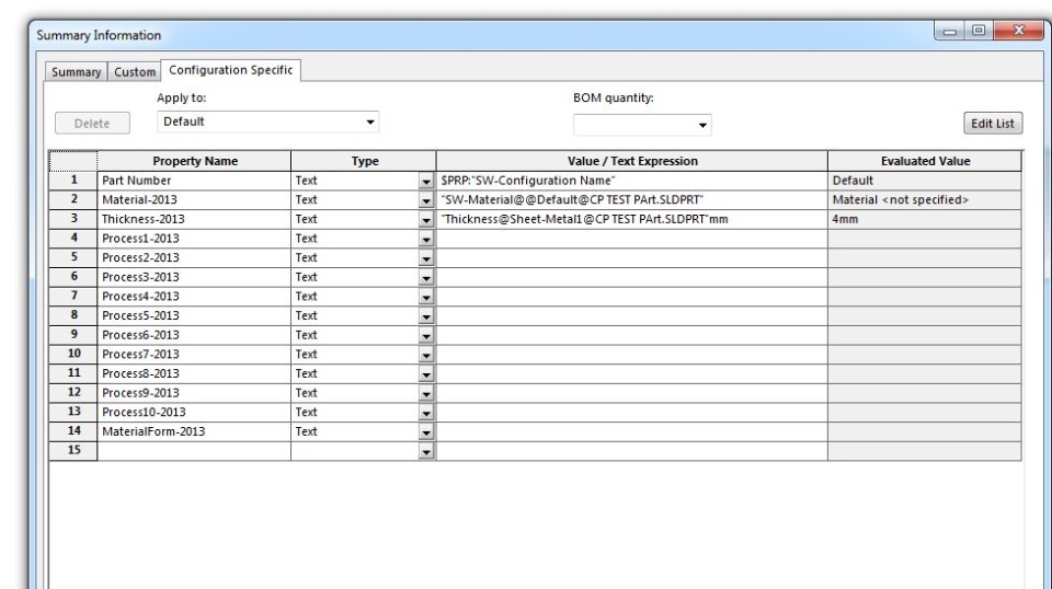

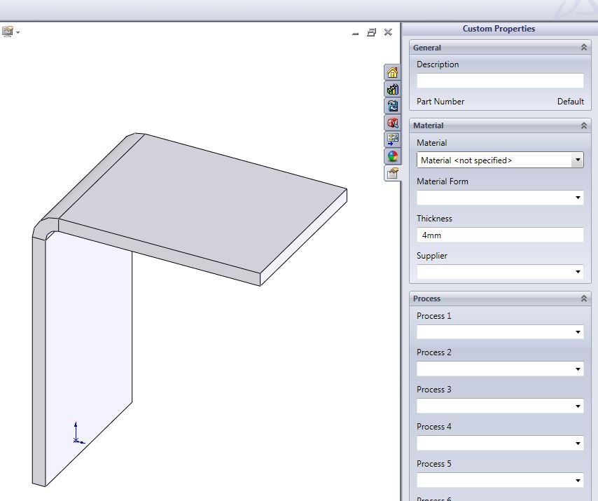

I have a problem were I cannont update a custom properties on the right side of the picture that are drop down lists, such as property "Material Form" (Variable name "MaterialForm-2013"). They are lists style custom properties with custom values allowed, so if one clicks in the box one can enter any text one wants or select a value from the drop down list.
Image "SW Custom Properties View"
This shows the custom properties and thier variable names.
Below is the code I have used to try and edit the custom properties.
  • It works for "Thisckness-2013"
  • It does not work for "MaterialForm-2013"
Does anyone know how I can get it to work on the lists style properties?
