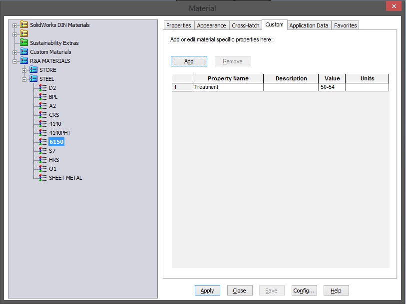

Hello, I am trying to link the properties of the part to this section of the material. Basically when I go to the part properties I have a material, weight, stock size, etc, and these are all automated. For example to get the material I have the following: "SW-Material@416.SLDPRT". So what I am trying to do is create a new Property that outputs the value 50-54 in the part properties. Or get this 50-54 value directly from the drawing sheet. Looking for the secret formula to link the part to this section of the material window.
I've tried stuff like "SW-Material-Treatment@416.SLDPRT" and "SW-Treatment@416.SLDPRT", but they don't seem to work. Anyone has any ideas?
