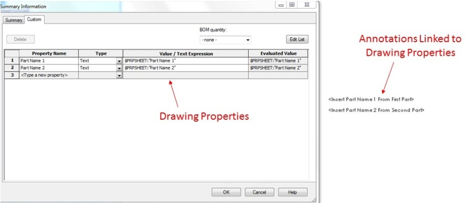

  • Link information in Part Custom Properties that is linked to Drawing Custom Properties

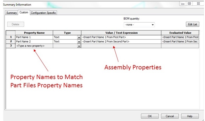

  • Link information in Assembly Custom Properties that is linked to Drawing Custom Properties
  • Link Drawing Custom Properties to Annotations in the Drawing
What I need to know:
  • Link information in Part Custom Properties that is linked to Assembly Custom Properties
Additional Information:
  • Solution Can't be a Macro (It just can't, not my choice.)
  • Needs to be something I can apply to my default Templates (i.e. .PRTDOT, .ASMDOT, & .DRWDOT)
Below I've attached some pictures with an example of what I am wanting.  Ultimately I want is Part Name ABC of the First Part & Part Name XYZ of the second part to populate through the assembly and populate the drawing annotations.
