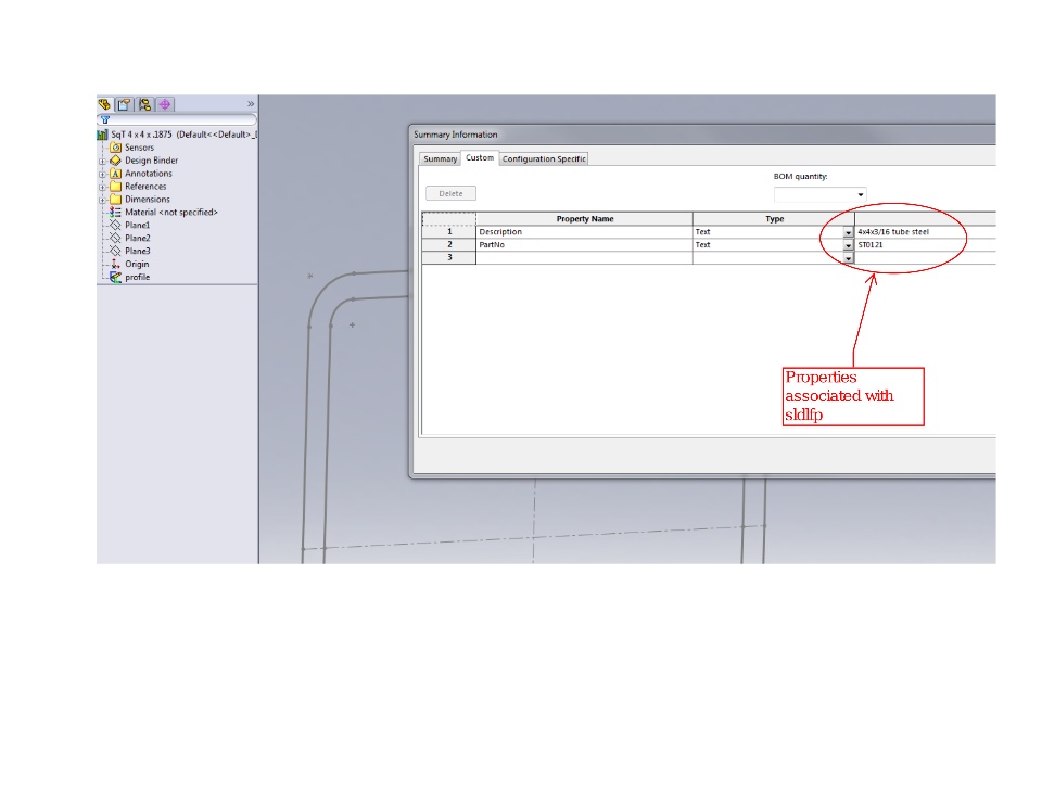

I created a list of my companies stocked material (ie RT, SqT, Angle, etc) in a library of .sldlfp with my companies assigned part number and description in each library feature parts properties. If I build an assembly of parts created from these sldlfps (not a weldment), how can I display their profile properties in the BOM? My goal is to be able to alter the parts by changing the sldlfp in each part and being able to display the correct part number (that matches the profile) in the BOM. I can almost get there by displaying an indented BOM, but this just makes the BOM bigger than it needs to be.
Thanks in advance for any assistance.
