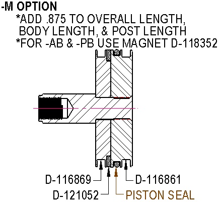

I want to know if there's a way to link part of a note in an assembly drawing to pull a custom property of an unused configuration of a part.
I have a view in my drawing that specifies a part, but a different configuration of the assembly uses a different config of the part with a different number.
The part actually shown gets its own callout with \\\$PRPSHEET:"Part_Number" in the text field. (Evaluates to D-121052 below)
However, rather than having an additional view of a different config to pull the correct part number, I just want it to be resolved in the note, itself.
I'm thinking something along the lines of \\\$PRPSHEET:"Part_Number@specified config name"
