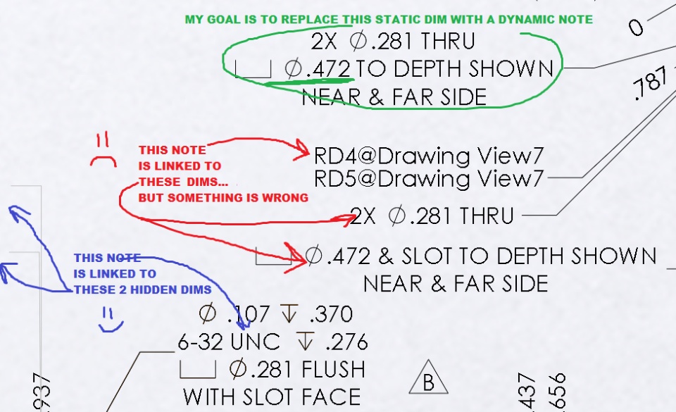

So I linked a note to 2 dimensions by , clicking one dimension, , click another dimension, .
It worked well to combine the two dimensions so I can hide them, but have a dynamic note.
I tried the same thing moments later and the note displays the link, "RD4@Drawing View7", not the dimension...
How did I do this?
How do I fix it?

The note is linked to a feature in the same view. The same feature the dims are referencing...
I can't imagine why it would work in one view and not another, but I tried changing the attachment... with no luck.

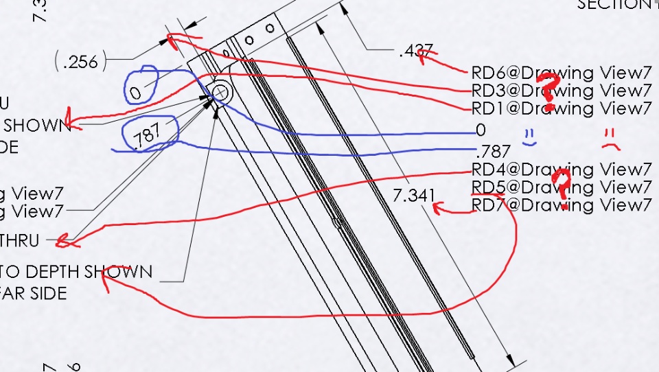

I tested the other dims in the drawing and every single one works EXCEPT the reg dims in this Aux view.
The Ordinate dims in the Aux view work....
What is going on here?
