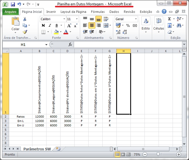

7- The table will open in excel, BUT WITH A DIFFERENT NAME!
     a) It will be named: "Design table in My Part"
     b) Not the correct name: "Part design - Design table" I have saved it as

I have added images of my specific design table. The correct name is "Dutos Montagem - Tabela de Projeto" and the table SolidWorks saves internally is named "Planilha em Dutos Montagem"
Please note that my SW is in Portuguese.
